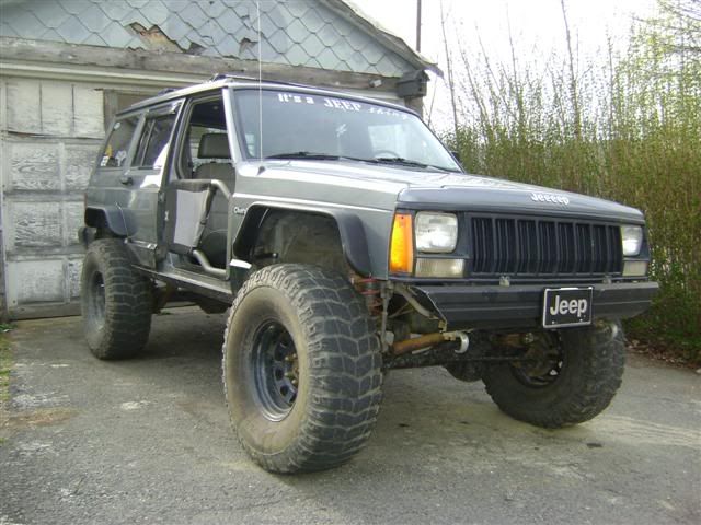

Anyone done tube fenders like this???
IllianaXJ
Support Your Local Trails
No problems yet. I do have frame stiffeners as Aaron suggested, as well as bumper tie-ins.
FlexdXJ
Gone but not forgotten...
I understand that, but not everyone is running stiffeners or cages.
If i'm wrong then fine, but the jeep pictured looks like it's welded to the rock slider and then to the bumper. I don't know if he has any other structure to the frame or anything else that would stop it from flexing. But if he doesn't, then I would be worried about the welds cracking the sliders or the bumper.
A stock xj frame flexes alot.
I understand that a stock XJ flexes but I think it would be fine.
No problems yet. I do have frame stiffeners as Aaron suggested.
Wasn't sure if you did or not.

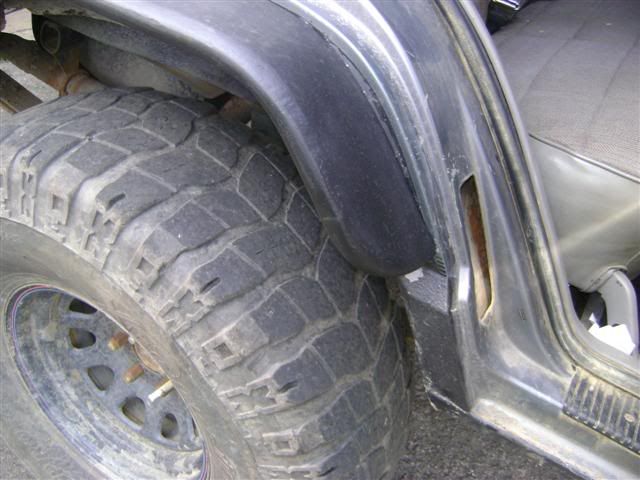

yes, his are really good. I'm nowhere near him in terms of fabbing stuff. But I didn't want to have to invest in the whole quarter panel gaurds to have tube flares. Mine are easy to unbolt and the are strong. I have less then 100 dollars in them so far.

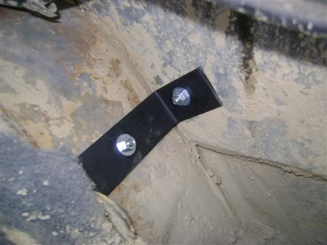

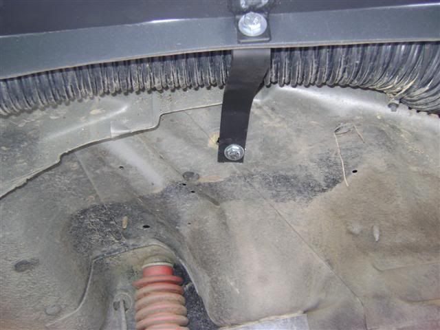

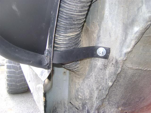

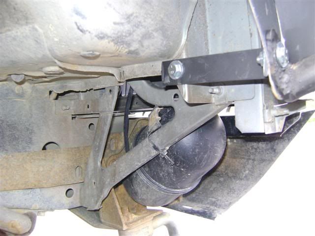

Here's some pics of the bracing. Like I said there are 3 on the front flares. One at each end and one in the middle. Here's the front.
Here's some of the rear. The angle that I have is going to be replaced. I would like to run it across to catch at least 2 tabs. That would help to distribute the wieght. The body seems pretty strong here and the flare is really solid as it is, but I would feel better if the angle was bigger.

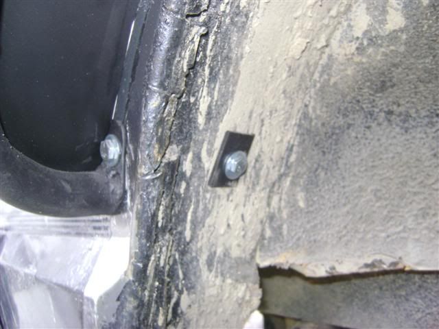

This is the rear most mount of the pass. rear flare.

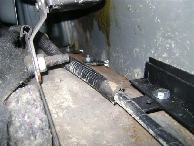

The front most mount. I had to go through the vent in the door jamb to bolt it up.
The underneath of the rear most mount. I used scraps of 1/8 steel as washers to try and prevent any pulling through of the bolts if I ever get caught on anything.
This is the tabs in the wheelwell again. Here you can see the middle tab that I want to tie the angle into. I just need a longer piece of angle.
So far I like them alot.
