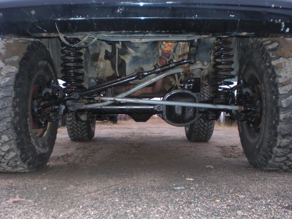

Hey guys I know the topic has been beaten to death, but my steering box is shot and my heep is lifted too high for the factory setup. I only want to change the setup one time thats why I am looking for some honest good advice. I am looking at an AGR steering box and pump with provisions to add hydro assist later, wondering about quality? Also going to do something like 1 ton steering or something over the knuckle at the same time.
Thank you for any info,
Mike
Heres a pic of the steering now(I know its bad)

- Grab some TREs (common 1-ton chevys) or rod ends of choice, tube adapters, and 1.5" 0.250" wall DOM will yield a simple drag link, tie rod, and panhard.
- New axle end panhard mount so angles are consistent.
- Rebuild stock pump, buy a reman, or buy a PSC high volume pump
- Rebuild the stock box/port it for assist or buy PSC box.
The end results of the above get you something like this (no hydro assist on this and not my XJ). Yes I understand this is high steer on a D44, but the same thing can be accomplished at a lower height on the stock arms of the D30 knuckles.
