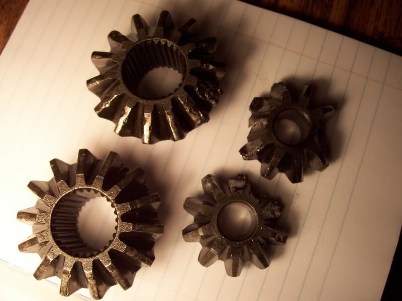

Begster
New member
This way when i am out wheelin any time one of the rear wheels are slipping i can apply the brake to that wheel and send more power to the wheel that is gripping.
This is just an idea that i had the other night. I want your thoughts on this thanks for any help!!!!
This is what I ended up with last time I tried to use the brakes to try to lock up the spinning tire to send more power to the wheel that is gripping. I've seen this on a number of cases.
