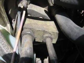

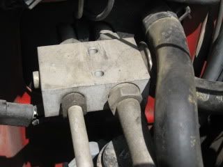

I know I know, you guys are as tired of A\C questions as much as lift\tire questions, but here we go. In an effort to find out why the A\C in my 88 does not work as well as my 91 I have been comparing the two to see what differences there are. Both have been converted to r134, Both read about the same pressures, blend door, blower, all that stuff is fine, e-fan, clean condensor, etc. The only difference I could find (other than the obvious differences from renix to HO) is that the expansion block on the 88 is rotated 180 degrees from the way the 91 is. I have had the block off 3 years ago to do the heater core and I wonder if it is possible that I may have switched them around? I have an old evaperator lying around and it looks like the fittings are the same. Obviously the high and low pressure hoses will only fit one way due to the different fittings, but would this cause any reduction in efficiency?

I was only able to check my low side today, I need a new o-ring for my high side fitting. At idle it was about 35 and at 1500 rpm about 26. Same for both jeeps. At the beginning of the summer I pulled a vac, added oil, and added the proper amount of r134 as per the chrysler TSB on conversions.

I will get a thermometer tomorrow and check. Another thing I thought about is the fan speed. In the 91 it is still the stock speed (fairly slow even on high) and on the 88 I have wired in a relay on the high speed circuit to give 12 volts to the blower, thus making it move a lot more air. Could I be blowing too much air and my A\C can't keep up?
