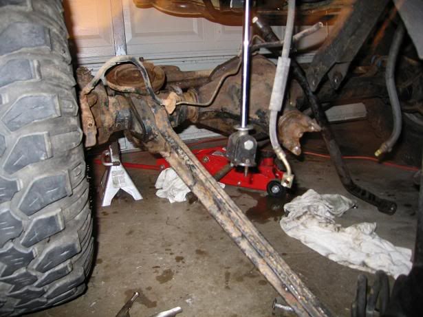

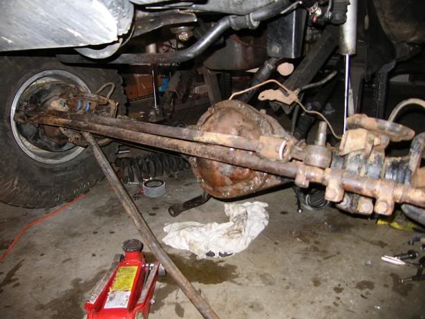

These are welded:
I'm not sure you'll have much success using the RE bracket kit with this axle. I think there may be a few guys that have made it work, but I would say that most have gone with some sort of radius arm set-up for their suspensions.
