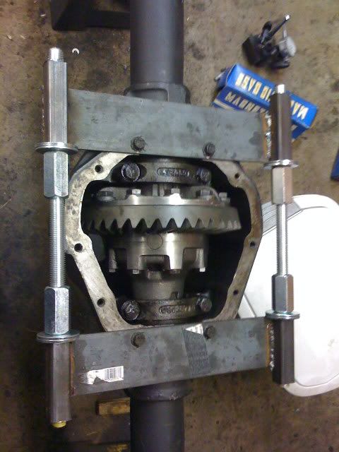

I've heard of people making Dana axle housing spreaders, never seen any in depth discusion on how to make one.
I found this a couple years ago and misplaced the picture and found it again with a quick search.
Seems to be pretty easy to make, some plate, all thread and a couple nuts and washers.

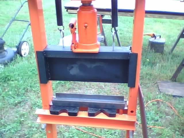

A press brake using a press

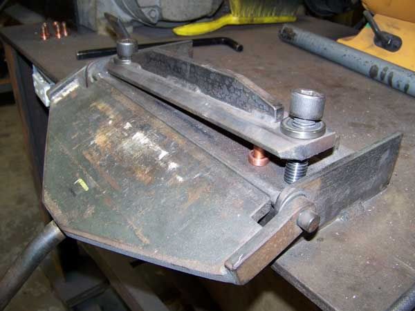

And another version

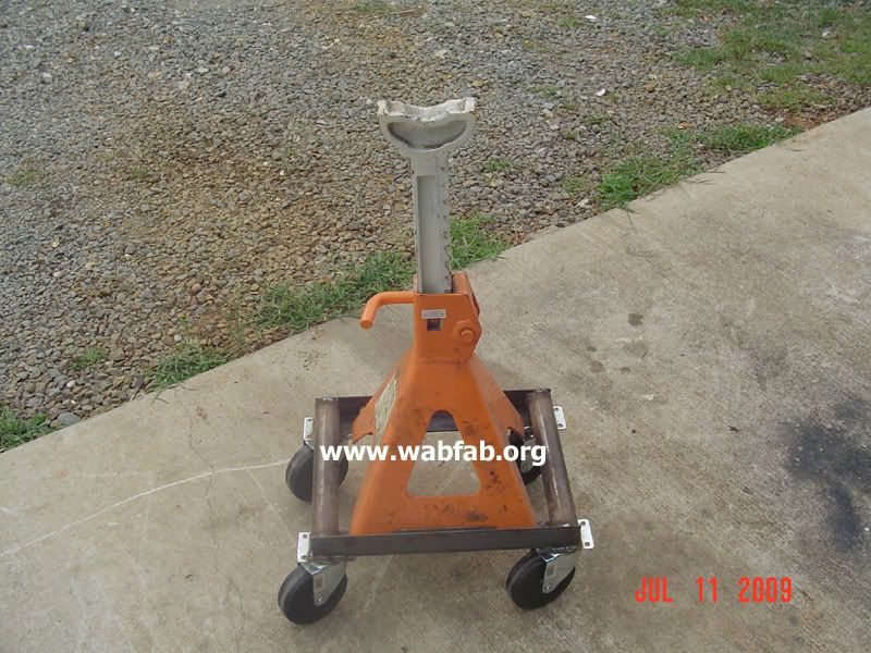

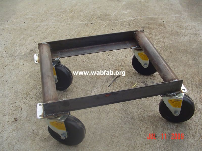

I did something similar:
http://www.bsfab.net/?p=23
Funny....
That's mine. I thought I recognized all the crap in the background. This is a really easy tool to make and was extremely usefull setting up mt D60 and 44.

If you make either of these, make sure to put a little grease on the threads.
