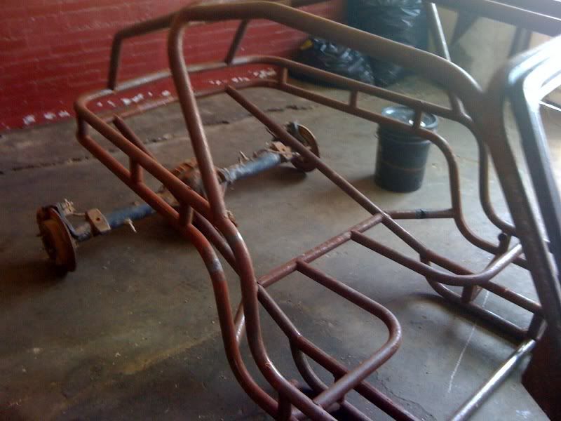

It is probably going to be a pretty slow going build. Here is my new tube chassis, and I will very likely be using my 4.0/AW4 combo to power this buggy, now that I have worked out the wiring details. Plans are to run a full width D44/9" combo, some 40-42" tires, coilovers/airshocks, 4 links rear, radius arm front, and who knows what all other goodies.
Here are the pics....

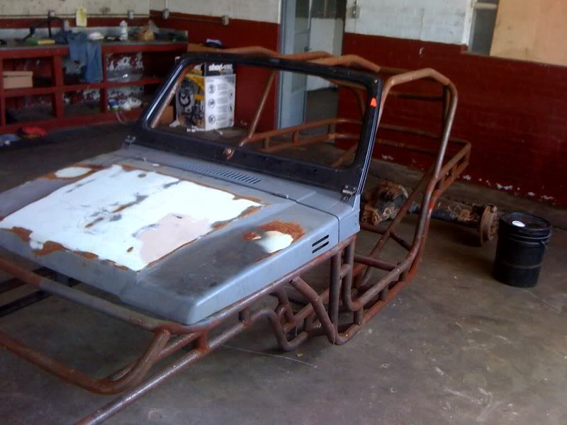

IF you are gonna run a buggy, at least take the sami hood off and throw something jeep oriented on...
and i'll take a chassis if you have any extras laying around sounds like a fun undertaking

LOL Well Tyler the buggy will at the very least be running my XJ powerplant. But I am also looking to try to make it more "Cherokee Like" I am going to do some experimenting with my hood and grille to see if I can make it work on there.
