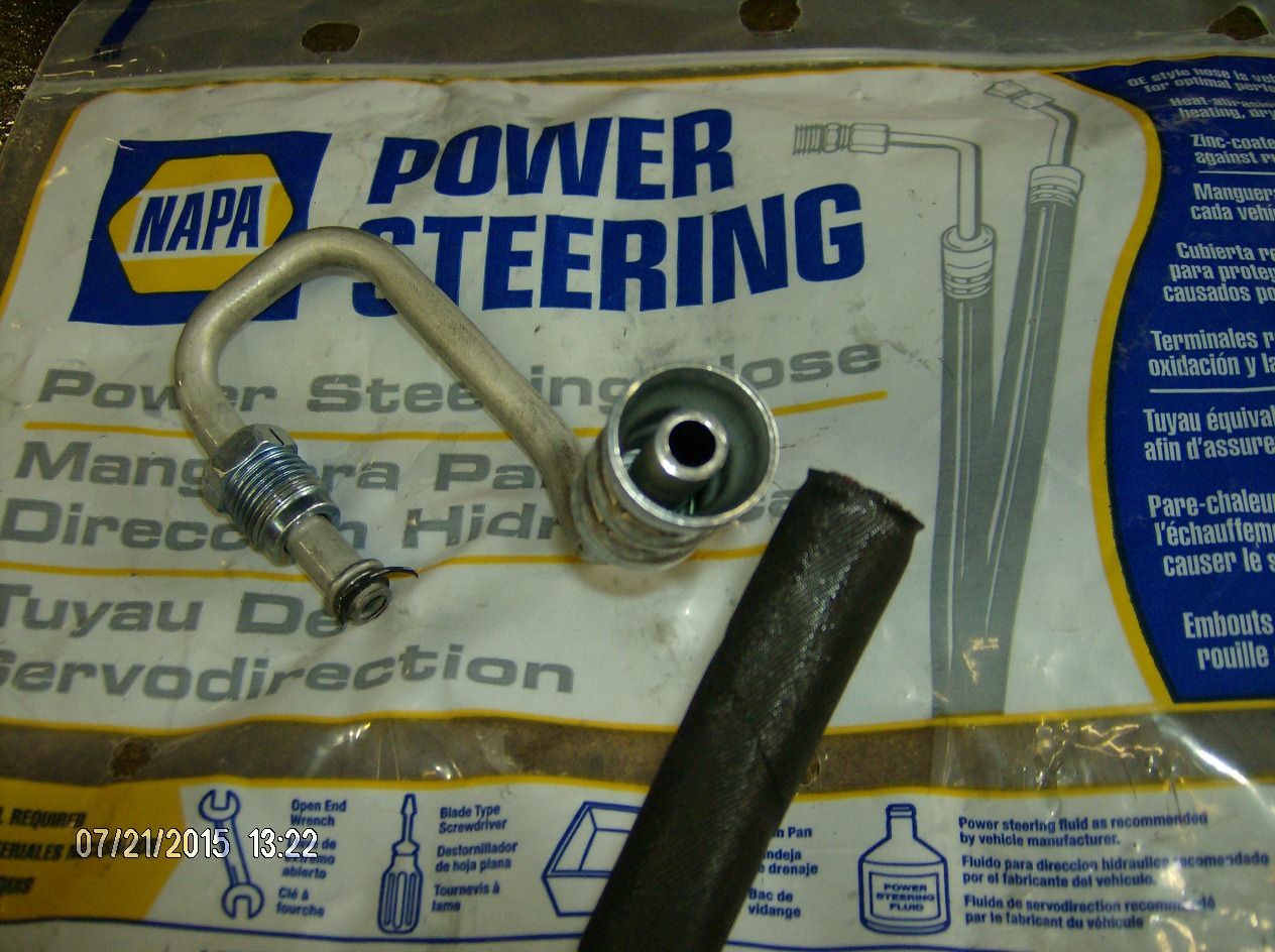

Interesting. That is not what either the hose that was on there or the Gates 363510 hose looks like!
Is there no way that the pressure could be too high in the return line? I'm happy to replace the hose again, but I don't want to just band aid another problem.

No, I know exactly where the leak is exactly where I keep saying, at the juncture between the steel tube and the hose on the low pressure hose. (It doesn't leak at the reservoir, presumably because the barb is bigger so it seals better.) As I keep writing, If I really crank a hose clamp down on the low pressure side, it will hold for a couple of days. Then it will start to leak. Then I crank the hose clamp down tighter. Then I break the hose clamp. The brand new factory crimp hose leaks from the get-go. (Google the Gates part number I posted if you don't know what the factory low pressure hose looks like.)

Awesome. I feel better knowing that pressure likely isn't the issue. I will run it with the cap off to be sure. I had thought of flaring the hose, so I'll probably give that a shot. I've also thought of trying to figure out if I can just toss a barb straight into the gear, but I'm not sure what threads they are exactly.
pjanda1
New member
A guy at O'Reilly suggested fuel line hose clamps. So I cut the Gates factory crimp off and put one on. No leaks yet, but I'll be watching.
