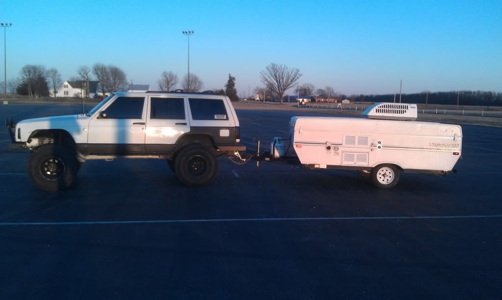

I towed this Aerolite all over the country, wheeled Moab and some of the Rubicon, on a D35 with 4.10 gears and a freshly rebuilt limited slip, on 31s.
I have a couple D35 shafts in the garage, want them?
