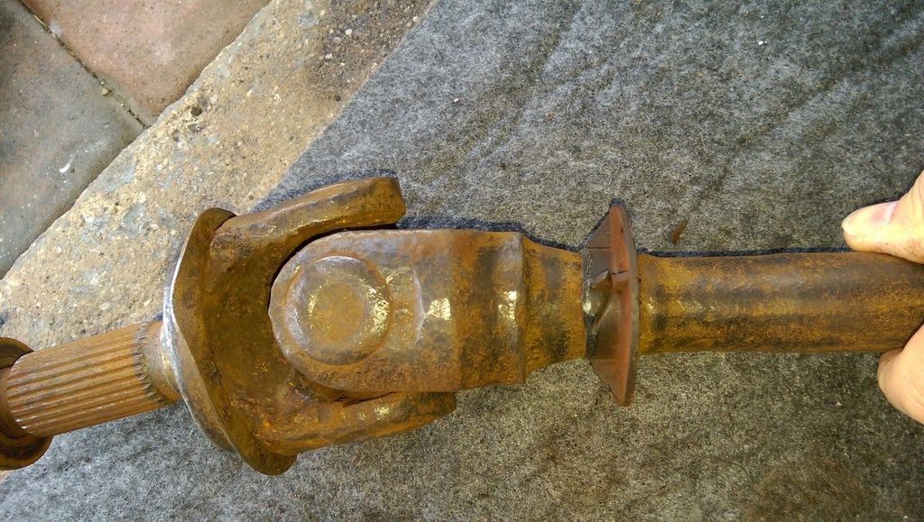

rusty axle shafts
garr
New member

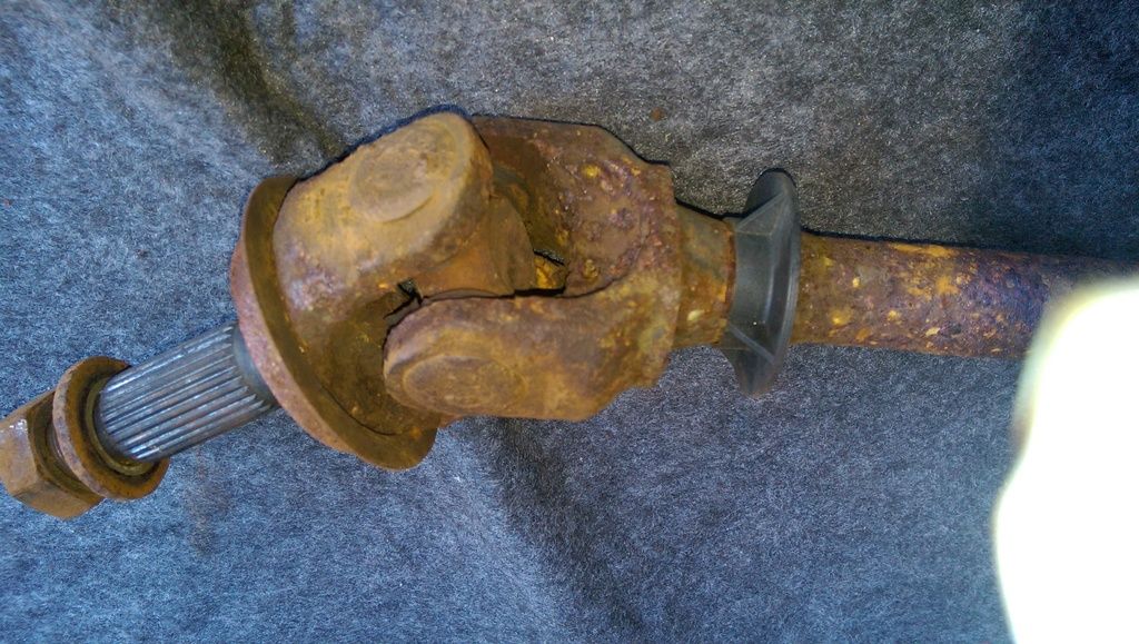

Wire wheel the rust, Apply POR15, new u-joints
OR just replace them?
What do you guys say?
ehall

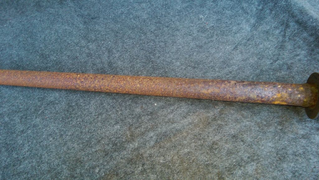

Its not the rust, its the pitting. The rust will clean off but if the metal is scarred it will be weak. Those look pretty bad.
rockauto sells dana/spicer parts now, you can buy new shafts for small dolla from them

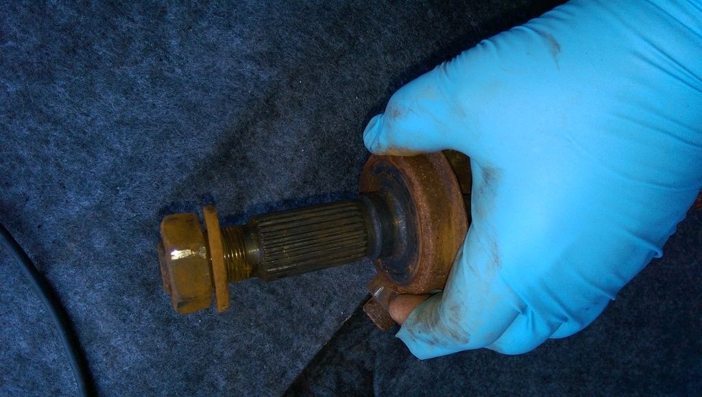

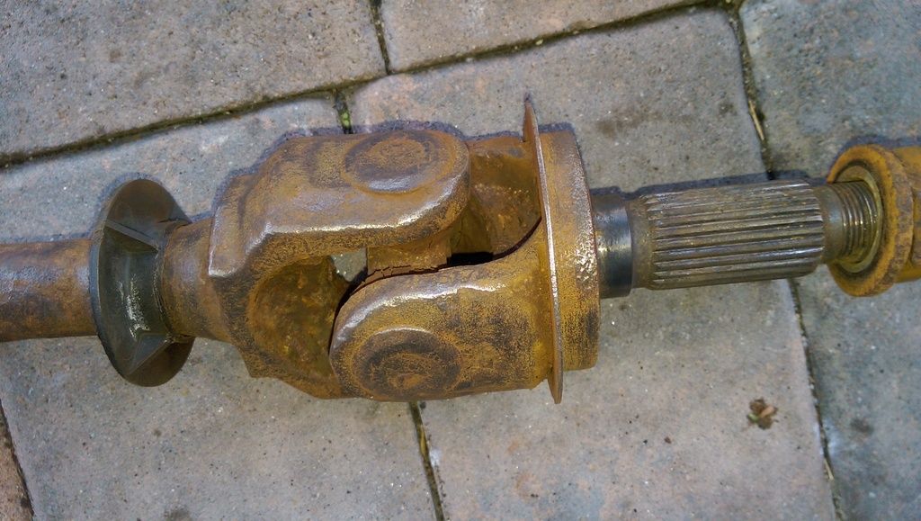

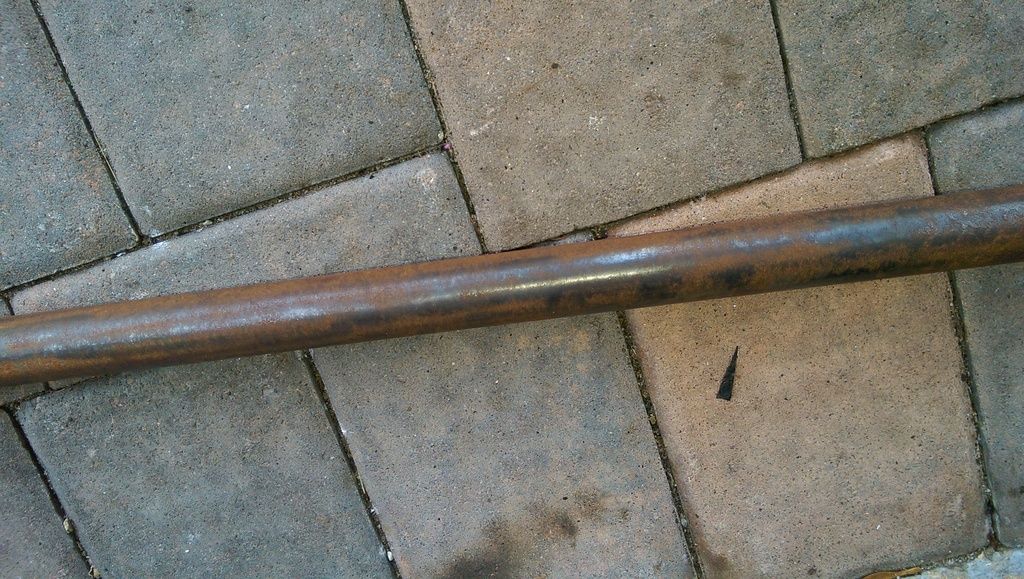

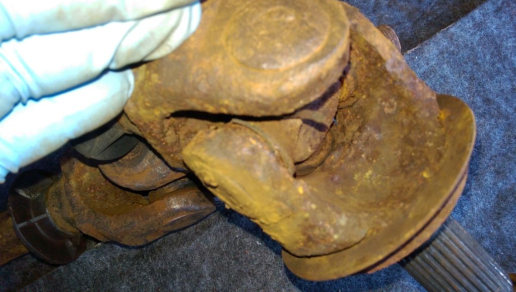

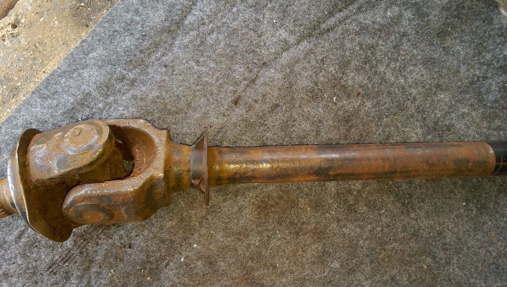

Thanks, I just gave them 10Minutes with a wire wheel, What do you think now?
ehall
You see where the inner shaft necks down just before the outer seal/guard (below the fleck of mud or whatever on the carpet), that is the weakest spot (other than the splines in the housing). Take a close look there for any kind of severe pitting. It looks minimal from the picture but you can see it better in person.
