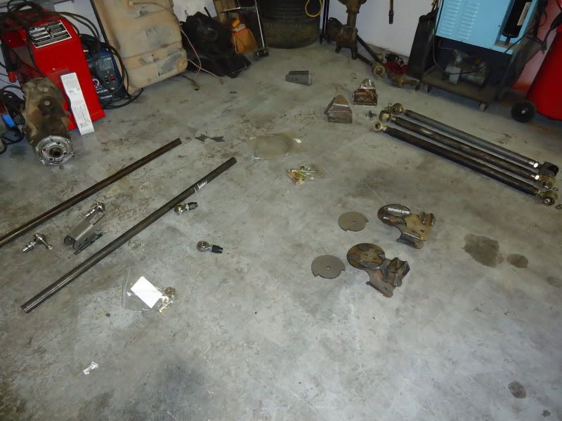

Kinda like four play all layed out new hardware that stuff is SEXY
