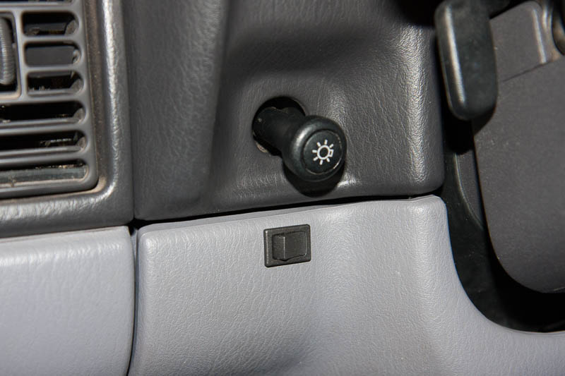

Me too. On more than one occasion. And it's annoying as hell having to jump your own vehicle in your own garage. :doh:
That's why I finally did something about it last weekend: installed a dome light override switch. Now I can switch off all interior lights and leave the doors open all day long. Works like a champ!
