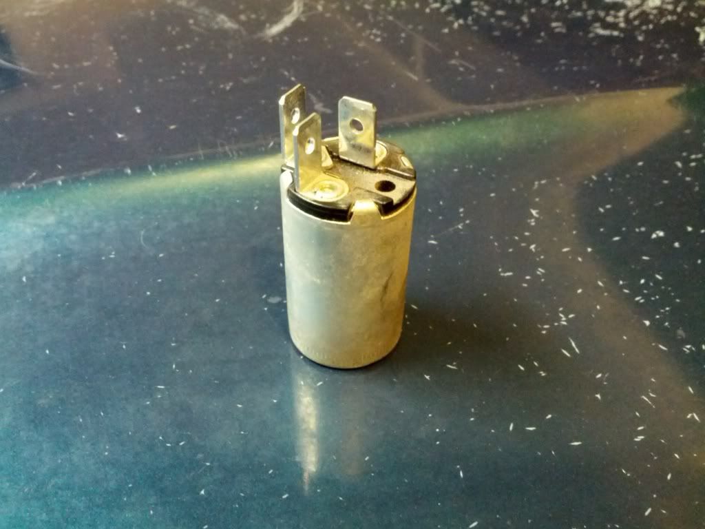

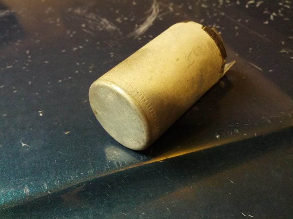

So have a question. I was replacing the light switch on the instrument cluster and left power connected. After removal of the switch and install of the "new" switch and doing the final securing I felt something warm on my arm. I found that it was this metal tube. Its a 3 prong no marking part. Nothing stamped on its side, and looks like its factory. Every thing appears to work with the cylinder removed. Should I re-install it? Is it normal to get warm? What is it? I have looked through the electrical manuals but cant find anything that would be like this... would it be the ignition time delay relay??? it looks like it is a match from something on RockAuto and the only thing I can see in the wire diagram. What are symptoms if its bad? Also to note this was warm when their was no key in the ignition, but lights where on. Ambient garage temp is about 58 deg F if that maters.

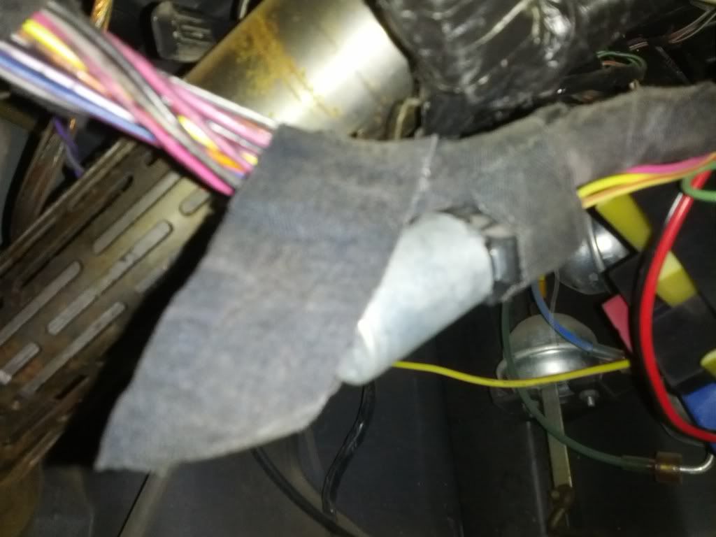

Can you tell me EXACTLY where this was located.....
As luck would have it, my dash is torn apart right now. If I have the same part and can locate it, I might be able to shed some more light on this....
Mine is a '98 so it might be different???
Magus2727
New member
It is right under the steering column. In a large bundle of wire. Basically centered with the driver at about just below knee level behind the metal and plastic of the front dash assembly.

Well, sorry to say, I looked and can't see anything like what you've got. Like I said tho, mine is a '98...

techno1154
That thing have nothing to do with the head lights.
I do not remember exactly what it does,...I think it have more to do with the halo lights around the key switch. The one in my XJ, 1996 also get hot/warm when the door is open. I will have to look it up and get back with the answer.
