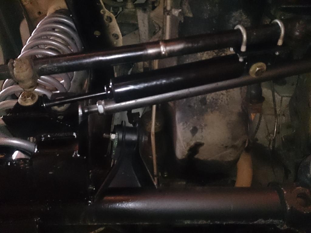

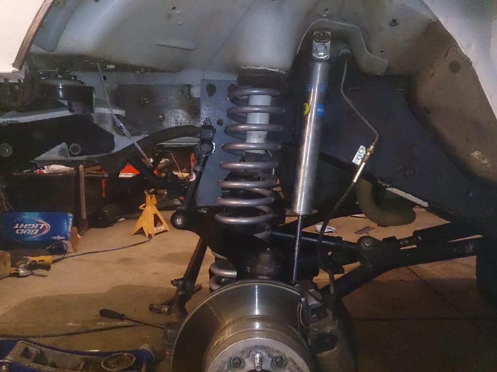

Replaced my front shocks tonight. Now I've got 5100's front and rear.
New front shock vs old front shock. The front seems to be sitting higher- I think the old shocks were acting as limiting straps. Rides a ton better.

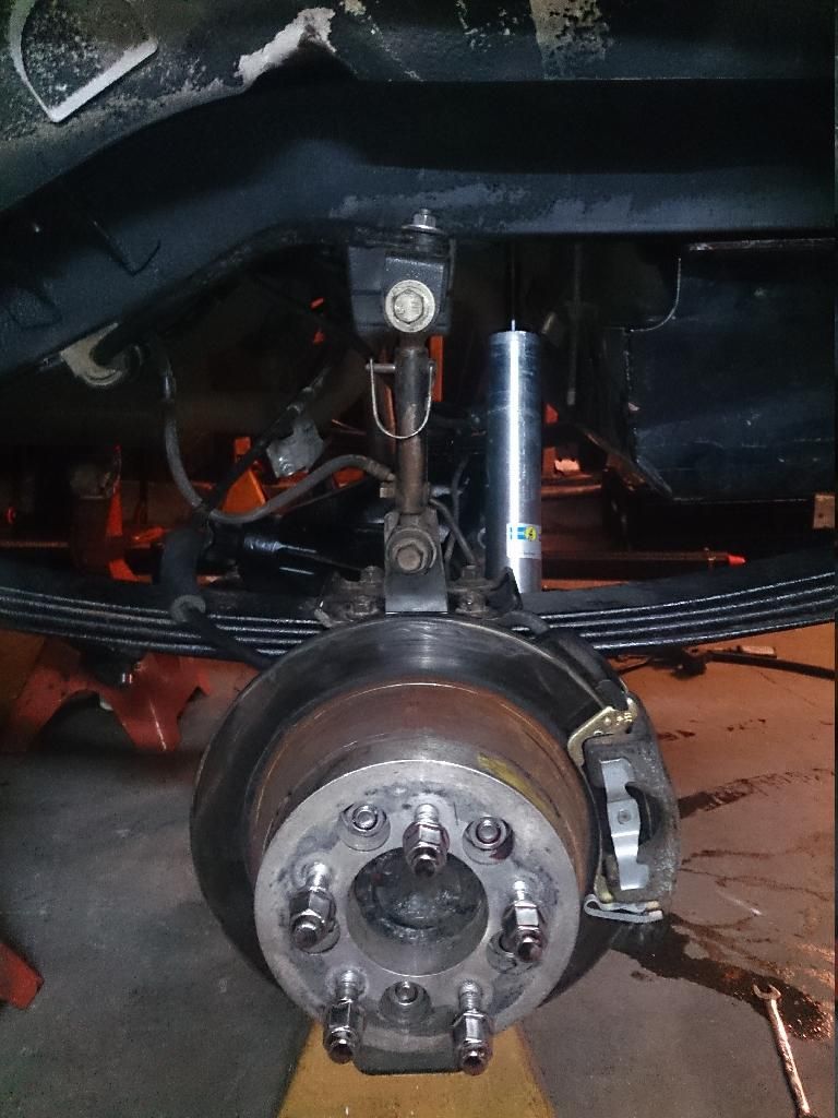

Finnnnaaaaaaaallllllyyy swapped to rear discs. Replaced nose pinion bearing got the billiondith time. I really need to swap out my leafs so that the nose of the onion is pointed so skyward.

What did you use to swap to disks Will? theres some KJs at the yard and I keep thinking about picking up the whole complete rear brake setup, I just havent had problems with the drums

It's hard to quantify it as a percentage but I can tell for sure. Keep in mind that I hadn't driven the jeep for a month or two prior with the pinion bearing having gone bad again. I definitely like it and we'll see how it improves over time and I gain the "feel for it". I've already done the master cylinder orifice change as well.
I need to still do the parking brakes. My dad and I were playing around with modifying the stock cables as I've heard people have done but I can't find a write-up on it.

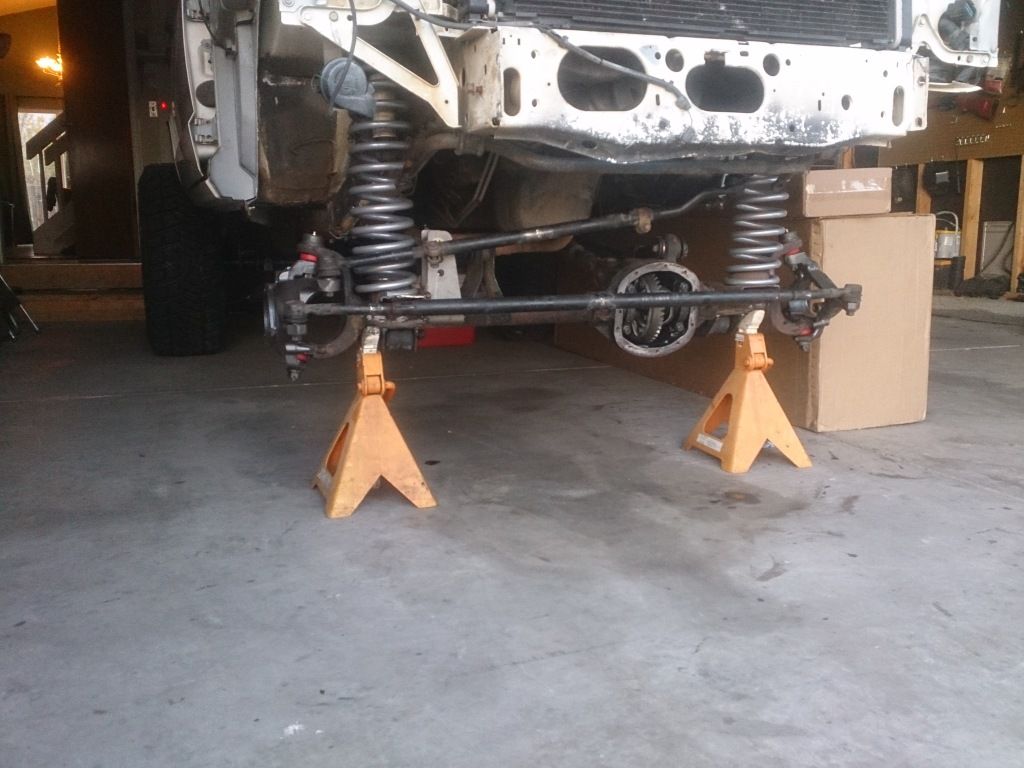

rear ZJ brakes are amazing but if you want some serious stopping power swap your fronts to WJ dual piston setup
eflores
New member
oh its not that hard ya big baby
the hardest part is moving the trac bar up
you can kind of see them here. they are large
and ZJ brakes out back
