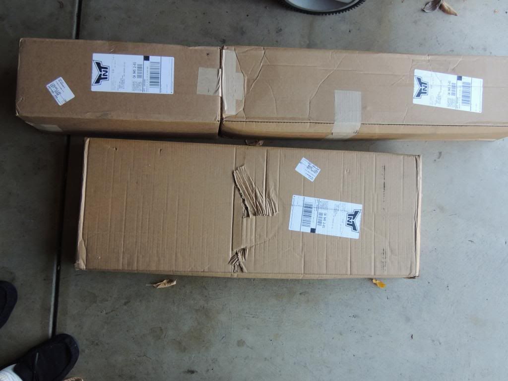

Look what the brown truck Santa brought for me today..
I got these 3 boxes
that contained all of this
to replace all of this :yelclap:
For those that were at this years SierraFest you may remember that I won a gift certificate for a TnT XJ Belly Pan. Well, I found out that I could not use that with the Full Traction brackets. So I talked to TnT and they said they would apply the price of the belly pan gift certificate toward the full long arm upgrade. So I saved my lunch money and sprung for the full upgrade. TnT also told me that I will have to do some "massaging" of the belly pan/skid plate to fit my Atlas. So, when I get to doing the install I will post up what mod's needed done for it to fit properly. Just in case they happen to see this, I'd like to say thank you to TnT Customs for donating the gift certificate and for working with me in applying that toward the long arm upgrade. Can't wait to get it installed and testing it out. :woohoo:
